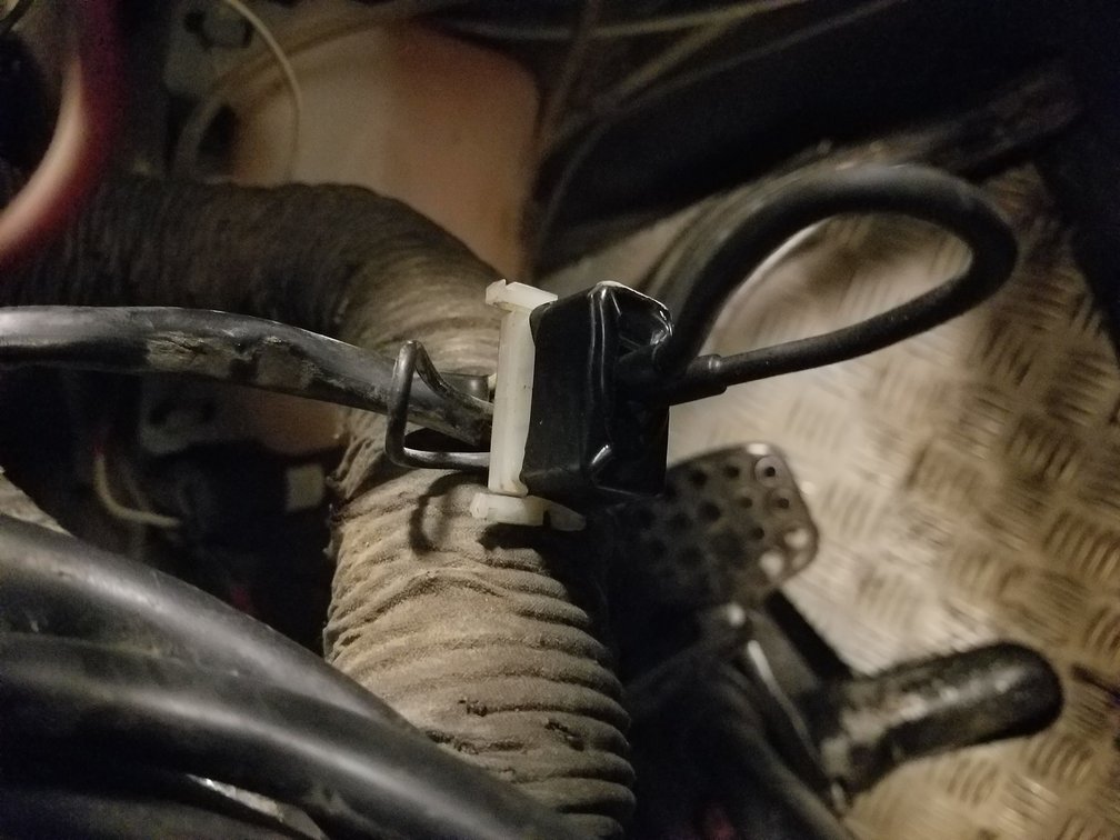

C'est sans doute le boitier "RPM" qui déconne.
D'autres ont déjà eu le problème; ci-joint un extrait du forum américain:
Since both the tach and engine performance were acting up, I suspect the 4500RPM box is failing - it will both cut ignition power (often gradually) which will start to confuse the tach. The weak ignition will result in weak engine power. The RPM box is a cigarette pack sized box under the dash with a six terminal connector plugged into it (two rows of three 1/4" terminals). Unplug the connector and create a jumper with mating terminals on each end of a short piece of wire and use it to jumper from the center terminal of one row with the center terminal of the other row. Now the RPM box is out of the circuit and the truck will run without it. If things go back to normal (full engine power, tach working right) then the RPM box is to blame. Replace it, or just leave the jumper in place as I did several years ago on my truck.
